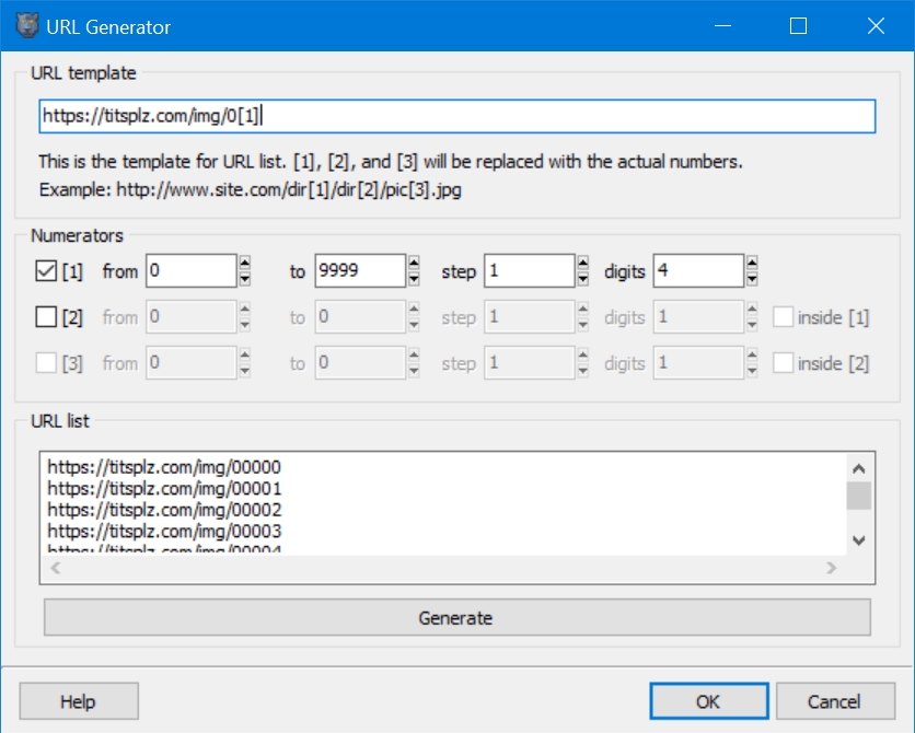

Why don't you create a project with a list of direct image URLs? You can use the built-in URL generator:
Exploration:
Regular site -> Current page only
Target Files:
Also in the [ Naming ] section, [ Additional ] tab add "jpg" extension to the saved files. Seems to be working just fine.
I do not recommend using more than 10,000 URLs per project, so you'll have to several projects to cover entire database.

Same issue, the id numbers are used for all sites so if you try to do it that way it will pull pictures from all five sites which is unwanted in this case. I also did try that anyhow, and it seems to have the same problem where it only gets so many before it stops. Usually around 230 or so as usual. Again I believe the program is following the url to Titsplz.com which redirects to a random picture, and then it will get a set 200 or more loaded on only that url (enough pictures forward and backwards).
so what will happen if you do this is eventually you'll see pictures from wangpics.com/etc but with the titsplz logo instead of the correct one.
