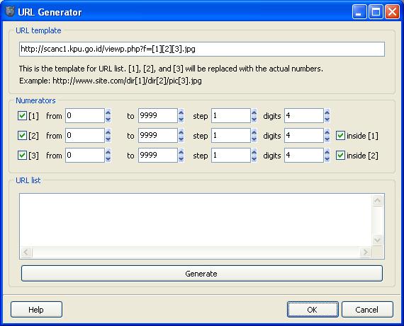

Well, you could try Extreme URL Generator:
http://www.exisoftware.com/url_generator/index.html
It doesn't limit you to 5 digits. Or you could use the following settings in the built-in URL Generator of Extreme Picture Finder:
Template:
http://scanc1.kpu.go.id/viewp.php?f=[1][2][3].jpg
The rest of the settings:
But I think it's going to be too hard for the program to work with so many addresses in one project, so I suggest you create several projects with different URL sets.
Template:

Re: Downloading Jpg Files Using generate number
I think 100,000 URLs per project is enough.What is recommended max project number?
Not much to explain here... You just iterate one number within another to make bigger numbers... Don't even know how to explain it. Just try and see for yourself.Can you please explain more about splitting
So use the settings from my pevious post (the one with the screenshot)... But it can take up to several hours to generate a list like this (depending on the CPU power). Plus, I don't think it's going t bring you any practical results.
