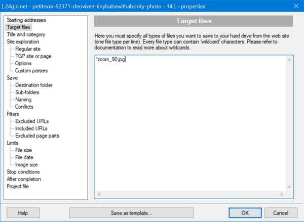

Yes, you can. You will need to add the following Custom Parser in the project properties:
Expression: "(http[^"]+-)box_175_175.jpg"
Result: [#1]zoom_90.jpg
And I think you should use the following mask in the Target Files:
to make sure only big files are saved.
where do I put it??
where do I put it??
- Posts: 2427
Re: https://peopleimages.com
You mean thumbnail and full-size images are located on different servers? Like thumbnail on cdn0 and full-size image on cdn2?
As for Target Files - open the project properties (menu item [ Project -> Project properties... ] ) select the "Target files" section and replace
with
with

- Posts: 2427
Expression: "(http[^"]+-)fit_400_400.jpg"
