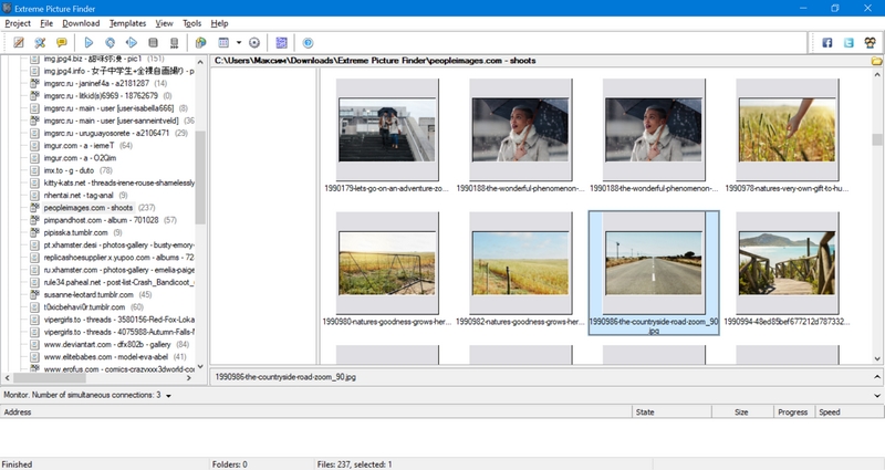

Re: https://peopleimages.com
Then you did something wrong. Worked perfectly fine for me with all the settings from this thread. Here is the result (237 full-size images):
Here is the project I created in 1 minute by simply following the instructions from this thread:
peopleimages.com - shoots
Right-click the above link, select "Save link as..." then double-click the saved file to open it with Extreme Picture Finder.
