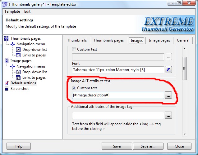

There is a way to do it in the built-in template editor. Take a look at the image below.
On the example above the long description of the image will be used for the ALT attribute. But you can use any text in this field or add any other Special tag using the [...] button near the edit field.
