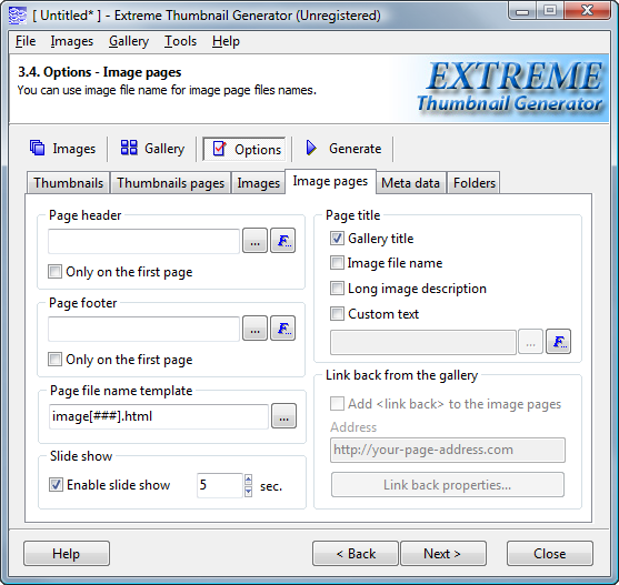

I like your program but would like it even better if there was a slide show option.
Is this an upcoming feature, or can you code it for me? If you can code it, what would the cost be.
I'd like to be able to control the delay (in seconds) between slides.

Dear Mel,
Latest version of Extreme Thumbnail Generator already have this feature. To enable the slide show in your gallery go to the gallery options and select the Image pages tab. There is a Slide show section where you can enable the slide show and change the delay in seconds. Take a look at the screenshot below.
